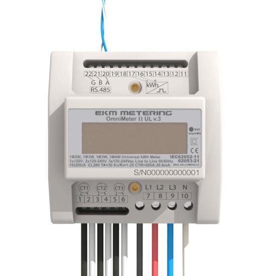

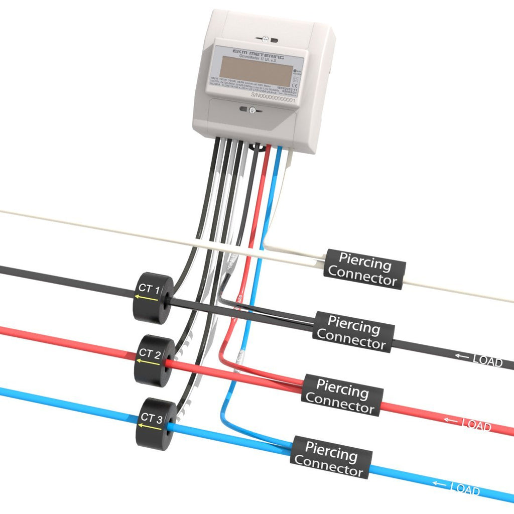

1x EKM Omnimeter: These are our universal kWh meters that are capable of accurately and reliably metering any electrical system in the world. They are perfect for your 3-Phase 4-Wire electrical system (sometimes called 3 Phase WYE (Y)).

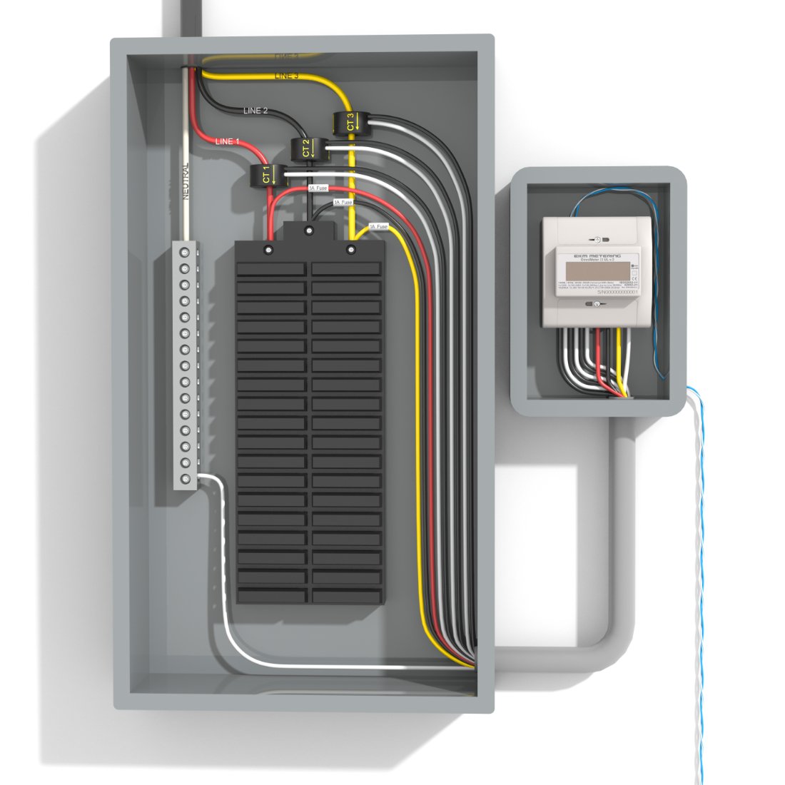

3x Current Transformers: The Current Transformers (CTs) are the little donut shaped devices that go around the hot wires being read. For a 3-Phase 4-Wire system, the meter will not function properly without THREE of these. To determine the CTs that are right for you, you will need to know the maximum amperage of your system and the wire outside diameter.

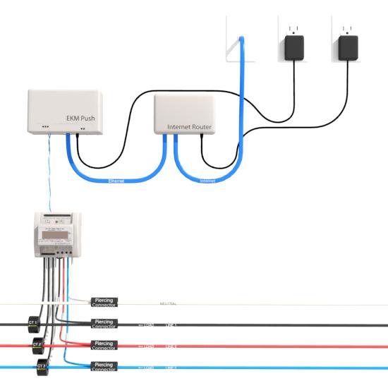

1x EKM Push3: This is the revolutionary communication gateway and cloud service that makes your meter data easily accessible in the cloud. Simply connect the Push3 gateway to your meter(s) and internet router. The Push3 will instantly begin to read your meters and send your meter data to the cloud. There is no setup or configuration needed.

1x Meter Enclosure: If you aren't mounting your meter in an existing panel or breaker box, we recommend you mount it in one of our water-tight or indoor enclosures.

3x Fuse Holders w/ 1A Fuses: The fuse holder is mounted inline on the hot wires that tap into the main hot lines and run to your meter. They are intended to additionally protect your meter in case of a power surge or some other unforeseen anomaly.
50ft CAT5 Cable: This wire (used for RS485 communications) contains four twisted pairs of wire. Only one of the twisted pair wires is required for the communications side of the metering. This is the wire that will be used to connect your meter to the EKM Push and/or to the USB Adapter. If there are multiple meters in the system, they can be connected to each other in a daisy chain.

4x Piercing Connectors: These will allow you to easily tap into your hot and neutral wires, and to run wires directly to your meter. These are the wires that power the meter and give it a voltage reference. These Piercing Connectors are optional but they can sometimes make installs easier.
1x Ethernet Cable: If You are planning to use the Push3 system, you will need an Ethernet cable to connect the Push3 gateway to your internet router, if you are not planning to connect via WiFi.

4x Wires (16-18 AWG): Connect to the main hot and neutral lines and then connect them to your meter. This is most easily done in conjunction with the Piercing Connectors listed above.
