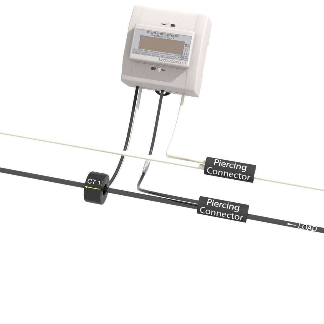

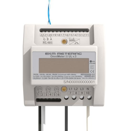

1x EKM Omnimeter: These are our universal kWh meters that are capable of accurately and reliably metering nearly any electrical system. They are perfect for your 120 Volt 2-Wire electrical system.
1x Current Transformer: The Current Transformer (CT) is the little donut shaped device that goes around the hot wire being read. For a 120V system, the meter will not function properly without one of these. Which CT is right for you will be determined by the diameter of your wire and the amperage of your electrical system.

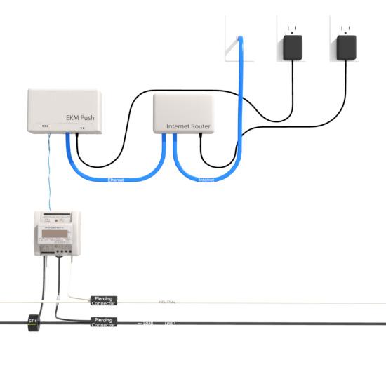

1x EKM Push3: This is the communication gateway that sends your meter data to the cloud. It works by simply connecting it to your meter(s) and internet router. The device will instantly begin to send your meter data to the cloud. There is no setup or network configuration needed (plug and play).

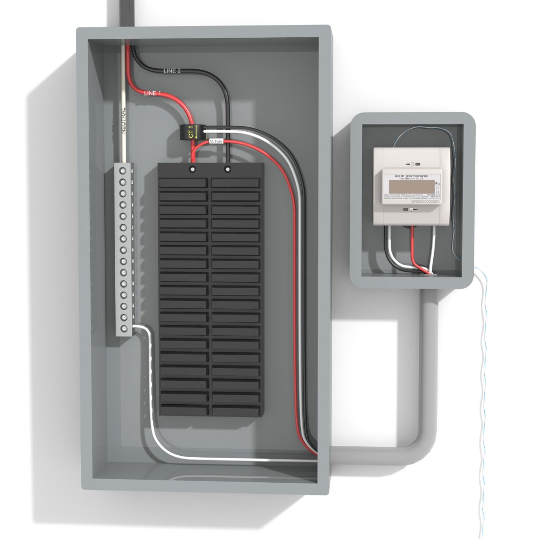

1x Meter Enclosure: If you aren't mounting your meter in an existing panel or breaker box, we recommend you mount it in one of our enclosures.

1x Fuse Holder w/ 1A Fuse: The fuse holder is mounted inline on the hot wire that taps into the main hot line and runs to your meter. It is intended to protect the meter in case of a power surge or some other unforeseen anomaly.
50ft Cat5 Cable: This wire contains four twisted pair wires. Only one of the twisted pair wires is required for the communications side of the metering. This is the wire that will be used to connect your meter to the EKM Push and/or the USB Adapter. If there are multiple meters in the system, they can be connected to each other in a daisy chain.

1x 12V DC Power Supply: This can be used to power a Push3 and/or 485Bee radio. Use a 12V DC Splitter in order to power both devices with a single power supply.
1x 12V DC splitter: Allows you to use a single 12V DC power supply to power two devices, like the EKM Push and 485Bee.
2x Piercing Connectors: These will allow you to easily tap into your hot and neutral wires, and to run wires directly to your meter. These are the wires that power the meter and give it a voltage reference.
1x Ethernet Cable: If You are planning to use the Push3 system, you will need an Ethernet cable to connect the Push3 gateway to your internet router, if you are not planning to connect via WiFi.

2x Wires (16-18 AWG): These are to tap into your hot and neutral lines and then run to your meter. This is most easily done in conjunction with the Piercing Connectors listed above.
